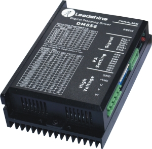

Next, i purchase 5 drivers from Leadshine
Costs:
Stepping drives, DM856 $70/pcs, 5pcs--------------$350
Express DHL Freight---------------------------------$36
Total: $386

About Drivers Leadshine DM856.
Manufacturer says the following:
The DM856 is a versatility fully digital stepping driver based on a DSP with advanced control
algorithm. The DM856 is the next generation of digital stepping motor controls. It brings a unique
level of system smoothness, providing optimum torque and nulls mid-range instability. Motor
auto-identification and parameter auto-configuration technology offers optimum responses with
different motors and easy-to-use. The driven motors can run with much smaller noise, lower
heating, smoother movement than most of the drivers in the markets. Its unique features make the
DM856 an ideal solution for applications that require low-speed smoothness
Features:
-- Anti-Resonance, provides optimum torque and nulls mid-range instability
-- Motor auto-identification and parameter auto-configuration technology, offers optimum responses with different motors
-- Multi-Stepping allows a low resolution step input to produce a higher microstep output for smooth system performance
-- Microstep resolutions programmable, from full-step to 102,400 steps/rev
-- Supply voltage up to +80 VDC
-- Output current programmable, from 0.5A to 5.6A
-- Pulse input frequency up to 200 KHz
-- TTL compatible and optically isolated input
-- Automatic idle-current reduction
-- Suitable for 2-phase and 4-phase motors
-- Support PUL/DIR and CW/CCWmodes
-- Over-voltage, over-current, phase-error protections
It is possible configure the driver via COM port or swithches.
We can compare this with the Gecko in price and performance?.

Hi Ros
I saw your youtube video pop up in my google alert for "Mechmate" - the motors move so well done.
My Mechmate is set up roughly the same in terms of drivers and motors. The Leadshine stepper motor drivers can be configured using a special serial cable and software called ProTuner. This process is just like tuning the gecko drivers but with the PC rather than a screw driver. Each motor is done one at a time.
To tune the motors, get the cable and run the software. It then looks for the resonant frequencies that the motor has and smooths that out for you.
Watch the protuner run and you will see that it runs the stepper motor through a range of RPM's to establish it's performance. Note the Protuner is run with the motor unloaded.
After you have finished remember to save the setting to the drive.
You can also use the software to set the the AMPS, microsteps and standstill current if the dip switches are set to allow you to do so.
Hope I have made the two functions of the ProTuner software reasonably clear for you.
Another type of "motor tuning" you might have read about in Mach3 is a further step that is additional to the two other functions I have outlined above.
Keep up the good work.
