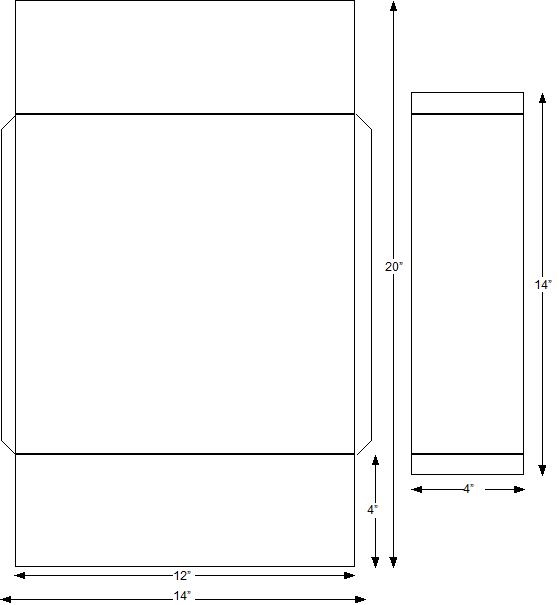

I'm building this from 18 gage, the sides will be spot welded in, top hinged, with a simple turn handle. Using box as test bed and permanent closure after testing software and finishing box. Software is some simple Cad/Cam, written in Visual Basic. That's my usb controler.

is that all the sheet metal you have?
Build the biggest box possible. Real estate is never enough once you started.

I think the box will be fine. It actually turned out 12"x20". I'm using the box for testing. After I'm satisfied with tests, motors will be removed and screen will be installed at bottom of box. My 23 motors are double shaft, so I don't have that motor installed backward for testing. 24v fan will be in door at top. Got lots of sheet metal.
