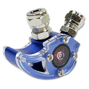

Buenos Aires
Argentina
today I ran it slowly for about an hour and then at 18000RPM for about 4 hours, the noise decreased substantially but its still there, Im not sure if the right thing to do is ask for a replacement or keep it. Will ask for the exact bearing model and research if its common to have that noise.
  #172
Old Wed 09 June 2010, 11:00
