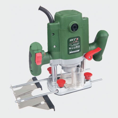

Hi Everybody
I have a wood router AWT/DWT Model: F-1200. I would obtain a electronic drawing for adapt in my mechmate project. Anybody can help me?
Follow details of my router:
Image:
Specs:
Trademark: AWT/DWT
Motor: Universal
Rated Power: 1200 W
No-load Speed: 11.500 - 32.000 RPM
Pliers Diameter: 6mm - 8mm - 1/4"

Good luck on getting plans.
The 1550W machine in post #98 stalled a few times in deep cuts on wood, so first decide whether the 1200W has enough power.
I think you'll be taking the side handles, base, legs and springs off and then looking for screws that you can take out and use for attaching a L-shaped base plate that you then bolt to the z-axis as shown in posts #99 and #102.
PS Even if you by-pass the on/off switch, keep the spark dampening box that's attached to the on/off switch, because this helps keep the tool alive longer
