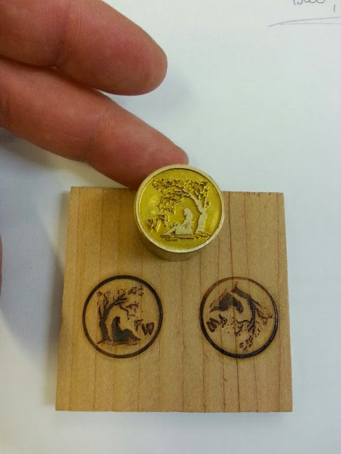

Engraving Brass
http://lh4.ggpht.com/-jTt9L9FzavI/VO...219_084918.jpg
Hi guys. Not posted for some time. Been very busy. Had to make a stamp to go on some products. Though I would try Brass. Worked ok for my first attempt. Still stunned how well this machine cuts.... details 10k rpm feed speed 1000mm min. Doc 0.2mm cutter I a 0.5mm dua ball nose. 0.25mm Rad. Total depth cut 1mm. Time 35mins

Very nice Andrew, I'll have to use your set-up for reference should I need to cut brass.

amazing how small this is....and done with your beast!!
Well done
