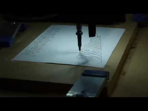

Just finished this up. Based on the post I made earlier
CNC plotter pen from design found online at instructables.com. , on Flickr

Plot Pen Test , on Flickr
YouTube Video

Looks great Pete...can I assume you give the plotter pen set-up thumbs up?

Yes. It does work well. I was just saying that I can make a large banner with the different color pens. The only down side is they are only available in green, red, blue and black.

Yeah, I am sure more colors would be nice. Silly question, do you just install that in the 1/2" collet of your spindle/router?

Yes. It is held in the 1/2" collet. I do use tape to keep the spindle from free spinning.
