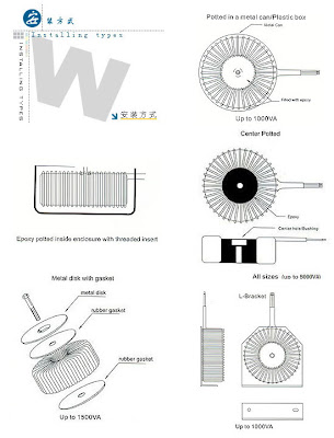

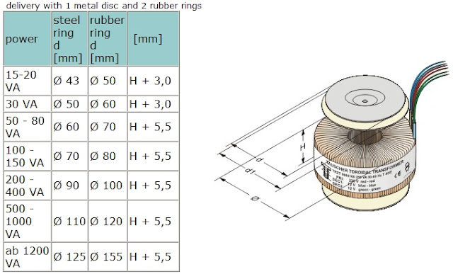

Toroidal Mounting
Surfing the web I have found thid pictures about toroidal trafo mounting:
I think the mounting epoxy may have less cooling
what do you think?
  #14
Old Fri 19 June 2009, 12:41
Gerald D
Just call me: Gerald (retired)
Cape Town
The 22000UFX75V capacitor will work perfectly.
I will never buy a capacitor secondhand - they can be old and damaged. They are actually fragile, oil-filled devices which can corrode/leak and make explosions.
Our 300VA transformers are running very cool - the mounting method will not make any difference to the cooling. The metal disk + screw method is very common and I havn't heard of any problems with it. I cannot see the benefit of epoxy for this application?
