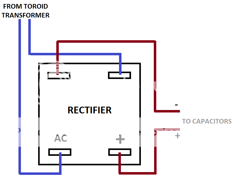

Copied from another thread:
I have this rectifier. I have 33 AC volts going into it and 87 DC volts coming out... What am I doing wrong? I have a 30 volt transformer so I was expecting something like 42 DC Volts.

Blake, a rectifier cannot cause a 260% increase in voltage. My first reaction is that your voltmeter is (very) faulty. Can you provide some pictures of your wiring connections and your voltmeter setup?

Blake
Did you wire the rectifier like this :

Yes I did Sergio. Thanks for taking the time to draw that very clear diagram. I wish I would have had it sooner because I had to do some digging to find out how to wire it.
The problem cleared itself up as I worked with it. I am not sure what happened but I am suspecting that it was a grounding problem. It is securely grounded now and reading correctly.
